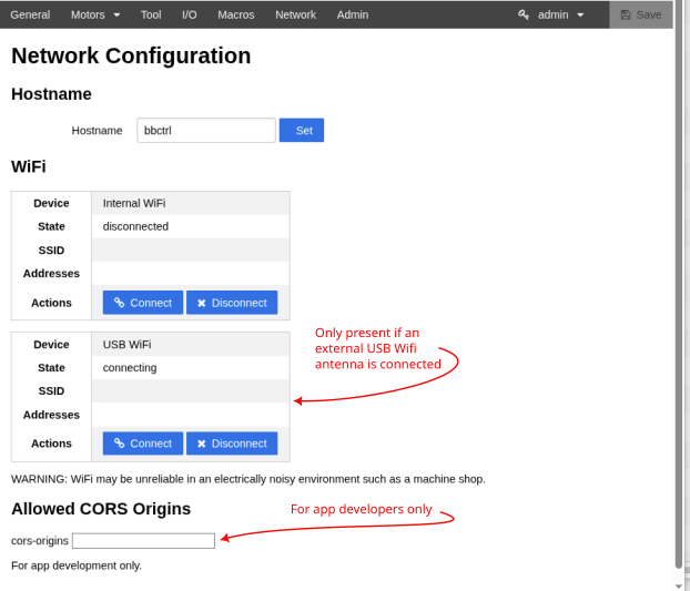

Network
The Buildbotics Controller offers wired and wireless network connections. Wireless connections can be configured from the Network tab on the SETTINGS Page.
While Internet access is not required to operate the Buildbotics Controller, it is desired. Internet access provides direct access to this manual, and makes software upgrades very easy.
After the Buildbotics Controller is attached to a local area network, it can be accessed across the network by entering the hostname concatenated with .local (“hostname.local”) or the IP address of the Buildbotics Controller into the address bar on any standard browser.
The default hostname is “bbctrl”. So, new controllers can be accessed by putting “bbctrl.local” in the address bar of the browser. Some computers may not support the hostname.local address and require that the IP address be entered into the address bar.
The IP address can be acquired by scrolling to the “Network” LCD screen on the controller using the gamepad.
Enter 'hostname'.local or the IP address
Accessing the Buildbotics Controller from outside the local subnet is not supported.

Wireless
The Buildbotics CNC Controller has a built-in wireless adapter.
Buildbotics Controller and other connected devices communicate through a nearby wireless router.
Since the Wifi antenna for the Buildbotics Controller is inside the metal enclosure, the Wifi signal strength is significantly reduced. This may result in poor or no communications. To boost the signal strength, Buildbotics recommends a Wifi antenna. Not all USB Wifi antennas are compatible with the Buildbotics Controller. Antennas that utilize the MT7601u or the RT5370 chip set have been found to work correctly.
To install the antenna, simply plug it into an empty USB port on the Buildbotics Controller and configure the Builbotics Controller as described in the Network tab on the SETTINGS Page.

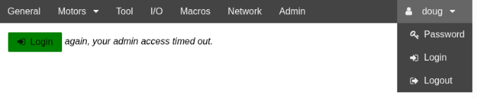

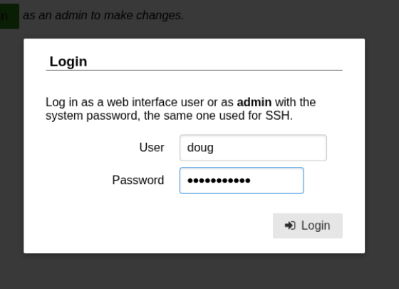

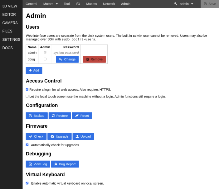

Network Security
Users have the option of restricting network access to the Buildbotics Controller.
Buildbotics Controller network login prompt.
The procedure for configuring network security, including granting and restricting access to users is described in the Admin tab on the SETTINGS Page.

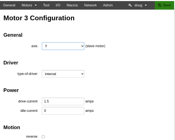

Some CNC machines use two motors to drive a single axis. If an unused motor output is available on the Buildbotics Controller, simply assign the second motor output to the same axis and connect the second axis motor to the second output.
A single output port can drive two motors with certain limitations. It is recommended that the motors be wired in parallel when driving two motors from a single motor output. The limitations are:
  • Since the two motors are wired in parallel, the current supplied by the motor output will be doubled. For instance, if each motor has a current rating of 2.8 amps, then the current on the motor output must be set to 5.6 amps. The maximum output current from a motor port on the Buldbotics Controller is 6 amps, so you cannot connect two motors that require more than 3 amps each to a single port.
  • When motors are wired in parallel on a single output port, they tend to resonate with one another. When the resonance occurs, the motors will stall. As a result, the motors must run at a speed below this resonance to avoid stalls. Unfortunately, it is not possible to predict the speed at which this resonance will occur without wiring them up and connecting them to the machine. Sometimes the affects of resonances can be reduced by adjusting microstepping, jerk, or acceleration on the Motors tab on the SETTINGS Page.
In many cases, the two motors will face one-another and must turn in opposite directions.
If the motors must turn in opposite directions, then one of the motors will have either the A+/A- pair reversed or the B+/B- pair reversed (but not both). The following image shows the B+/B- pair reversed on the motor on the right which causes the motors to turn in opposite directions.
Parallel motors wired to turn in opposite directions
Refer to the Motors tab on the SETTINGS Page for information on configuring motors.

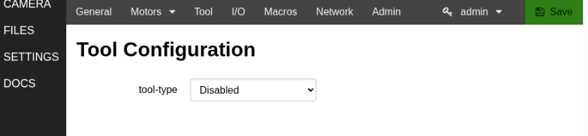

Refer to the Tool tab on the SETTINGS Page for instructions on how to configure the Buildbotics Controller to use the RS-485 interface. Refer to the spindle controller manual for instructions on how to configure the spindle controller (1).

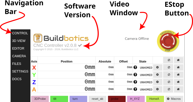

A dark gray 'navigation bar' is displayed on the left side of each page and provides links to each of the other pages. On small screens, this bar becomes a pull-down menu. Resizing the window to be narrow will also cause the bar to become a pull-down menu.
Emergency Stop Button
A yellow and red "emergency stop" button is present in the upper right part of the screen on all pages. Clicking this button puts the controller in the 'ESTOPPED' state. When 'ESTOPPED', all motors and the spindle are disabled, all position and homing information is lost, and the yellow ring blinks between orange and yellow.
Clicking the emergency stop button while the Buildbotics Controller is in the 'ESTOPPED' state attempts to clear the "emergency stop". If the "emergency stop" clears, the outer ring changes back to solid yellow. The "emergency stop" may not clear if the hardware "emergency stop" switch or if a limit switch is active.
The National Fire Protection Agency (NFPA 79) requires that the class of emergency stop button be determined through a risk assessment. The soft "emergency stop" button on these web pages and the estop pin (pin 23 on the DB25 I/O connector by default) are both software controlled, and cannot be used for safety. If your risk assessment requires an emergency stop button to be installed for safety purposes or mission critical applications, then Buildbotics LLC recommends installing a “listed“ hardware Emergency Stop button in line with system power.
Software Version
The current software version is displayed just below the Buildbotics logo. A check mark is displayed next to the version number if the latest version is currently loaded. If a new version is available, a recommendation to upgrade to the latest version is displayed. The check mark and recommendation are not displayed if internet access is not available.
Automatic checking for new software versions can be disabled from the Admin tab on the SETTINGS page.

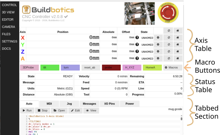

The CONTROL Page consists of the Axis Table, the Macro Buttons Section, the Status Table, and the Tabbed Section.
Axis Table
The Axis table is at the top of the CONTROL page and gives the following information for each active axis:
  • Position - This is the logical position. GCode commands and programs will move relative to this position. For instance, the command “G0 X10” will cause the X axis to move to 10mm and 10mm will reflect in this field. This assumes that metric units and absolute position mode are being used. This value will also show on the LCD 'Ready' screen.
  • Absolute - This is the actual position of the machine relative to its homed value.
  • Offset - Offset is equal to Position - Absolute. This is useful when you want your program to run from some position other than home. For instance, the physical home value may be at the lowest position along an axis, but the program causes the axis to move to negative values. The offset can shift the zero position to another point along the axis.
Axis Table on Control Page

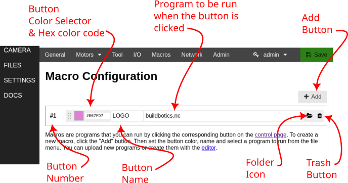

Macro Buttons
The Macro Buttons section of the 'CONTROL' Page provides a button for each Macro button that has been assigned. Each button is labeled with the name and color that is assigned to the button. Simply click one of these buttons to run the program that has been assigned to that button.
The last button is gray in color, has a gear icon, and is labeled 'Macros'. Clicking this button navigates to the 'Macros' tab on the 'SETTINGS' Page to view, add, or remove macro buttons.
Status Table
The status table provides real-time information about the state of the machine and programs.
The "State" field reflects the state of the CNC Controller and the current action being taken. The possible values in the state field are:

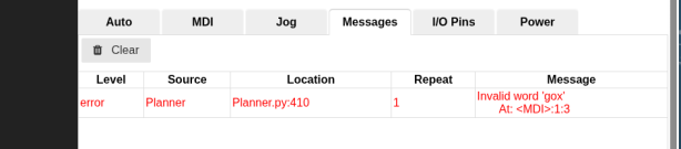

The 'Message' field is often blank, but may report a message to describe the machine state. More details can be found by selecting the 'Messages' Tab.

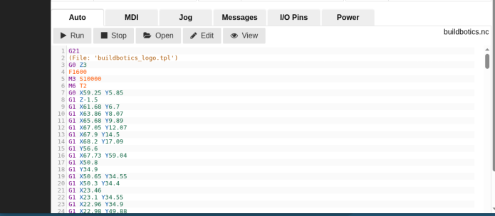

Auto Tab
The Auto tab provides controls for viewing and running GCode programs.
Auto Tab selected
When the Auto tab is selected and no program is running, the 'Run' button, the 'Stop' button, the 'Open' button, the 'Edit' button, and the 'View' button are displayed.
Click the Run button to execute the currently loaded program. This changes the 'State' to 'RUNNING', changes the 'Run' button to a 'Pause' button, and deactivates the 'Open' button.
Click the 'Pause' button to stop executing the currently loaded program. This changes the 'State' field to 'HOLDING' and changes the 'Pause' button to back to 'Run'. Click 'Run' again to resume execution from where it stopped.
Click 'Stop' to stop executing and exit from the program that is currently 'RUNNING' or 'HOLDING'.
Click 'Open' to select and load a different program.
Click 'Edit' to navigate to the EDITOR Page and begin editing the currently loaded program.
Click 'View' to navigate to the 3D VIEW Page to view the cut path simulation of the currently loaded program.
The program that is currently loaded is displayed in the scrolling window below the control buttons. This window will automatically scroll through the program as it is being processed and highlight the line that is currently being processed.
Users may notice that the actual cutting position lags the highlighted line. After a line is processed, it is put in a queue to be sent to the control hardware for execution.

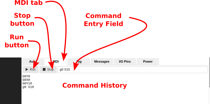

MDI Tab
The Manual Data Input (MDI) tab allows the user to control the machine by manually entering GCode commands.
MDI Tab selected
The 'Run' button causes the commands that are currently in the command entry field to be executed.
The 'Stop' button causes any commands that are currently executing to stop.
The command entry field accepts GCode commands from the user. Pressing the enter key after typing commands into the command entry field causes those commands to be executed.
The scrolling window of command history displays commands that have been executed. The most recent commands are displayed at the top. Clicking a previously executed command in the scrolling window causes that command to be loaded into the command entry field.

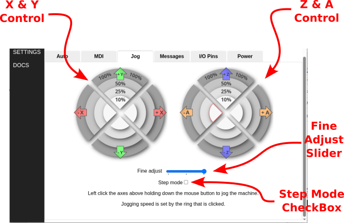

Jog Tab
The Jog tab allows users to jog the machine on any axis.
Jog Tab selected
The controls operate differently depending on the mode of the interface. If the step mode checkbox is unchecked, then the axis starts moving when you left-click and hold on the control and stops moving when you release. If the step mode checkbox is checked, the axis will move a specified distance when the control is clicked.
When in 'step mode', the distance moved is determined by the ring that is clicked. Each ring is labeled with an number that specifies the distance in the current units that the axis will move when clicked.
The current units are specified in the 'Units' field in the status table.
When in 'step mode', the integer values for each ring can be adjusted using the fine adjust slider. The 'fine adjust' slider can be on the left, in the middle, or on the right. The following table shows the distance ranges available when in 'step mode'.
Slider Position Inner Ring Second Ring Third Ring Outer Ring
Left .001 .01 .1 1
Middle .01 .1 1 10
Right .1 1 10 100
When not in step mode, the numbers on the controls represent the percent of the maximum speed for the axis at which the axis will move when left-clicking and holding. The maximum speed for the axis is set in the motor configuration.
Once again, the slider has three positions. The following table shows the percent of maximum speed that can be achieved by clicking the various rings with different 'fine adjust' settings.
Left .1% .25% .5% 1%
Middle 1% 2.5% 5% 10%
Right 10% 25% 50% 100%
Messages Tab
The Messages tab displays a running list of error and status messages. The most recent message is appended to the bottom of the list. These messages can assist in troubleshooting problems. The Message field gives a brief description of the issue and the Location field sometimes gives the source code file and line number where the issue was encountered.
The Repeat field reports the number of times that the issue has occurred.
Clicking the Clear button deletes the list of messages.

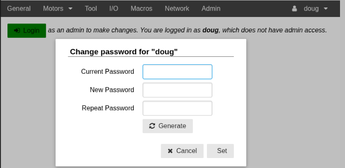

Administration and configuration of the Buildbotics Controller is done from the SETTINGS Page.
Only users with 'admin' privileges can make configuration changes on the SETTINGS Page.
The only thing that users without 'admin' privilege can do on the SETTINGS Page is change their password.

Motors Tab
The Buildbotics Controller has four motor ports labeled M0, M1, M2, and M3 respectively. Select the individual motor port from the Motor Tab pull down menu.
Motors Tab pull-down menu on the SETTINGS Page
The Motor Configuration Tab provides all configuration items specific to the selected port.
Motors Configuration Tab on the SETTINGS Page
The Motor Configuration Tab is subdivided into sections titled 'General', 'Driver', 'Power', 'Motion', 'Limits', and 'Homing'.
General
Within the 'General' section, select the axis to be assigned to the motor port from the 'axis' pull-down menu. Axis X, Y, Z, A, B, or C can be assigned to any motor port.
An axis can be assigned to more than one port. When an axis is assigned to a second port, only the 'type-of-driver, 'drive-current', 'idle-current', and 'reverse' fields can be configured for that subsequent motor port. The remaining fields are inherited from the first motor port assigned to that axis.
Second motor assigned to an axis.
Driver
The 'type-of-driver' pull-down menu allows selecting between 'internal' or 'external' drivers.
If 'internal' is selected the 'step-length' is set to .000002 seconds to match the needs of the internal drivers and the 'step-length' field is not displayed.
If 'external' is selected, the 'step-length' field is set by the user. This field should be set to match the step length requirement of the external driver being used.
Internal or External Driver
Power
The “Power” section configures the amount of current that will flow to the motors.
Check “enabled” to enable the axis. Only 'enabled' axes will appear in the Axis Table on the Control Page.
The drive-current entry box sets the maximum peak current in amps that is supplied to each motor coil. Users should look up this value on the motor data sheet. When connecting two motors in parallel on a single port, the maximum current should be set to double that shown in the motor data sheet. The drive current setting cannot be greater than 6 Amps.
The idle-current entry sets the peak holding current in amps that is supplied when the motor is not moving. In many cases, this can be set to zero. Some systems may require a value that is greater than zero to ensure that the motor holds its position when not moving. The maximum idle-current that can be assigned is 2 amps.

Tool Tab
Select the 'Tool' tab on the SETTINGS Page to configure spindles or lasers.
Tool Tab with tool type disabled
The fields in the Tool Configuration screen differ depending on the value selected in the 'tool-type' pull-down menu.
If the Buildbotics Controller does not control a spindle, set the ‘tool-type’ pull down menu to “Disabled”. When the spindle is “Disabled”, no other fields are present.
When ‘tool-type’ is not ‘Disabled’, the tool configuration is displayed in two sections. The fields in the upper section are common to all tool types.

Macros Tab
The Macros Tab on the SETTINGS Page is used to assign GCode programs to macro buttons that appear in the Macros section of the Control Page.
Macros Tab on the Settings Page
To create a new macro, click the Add button, select the color of the button and give it a name. Then, click the folder icon to select a program that will be assigned to the button. Finally, click 'Save'. A new button will appear in the Macros section of the Control Page with the color and name that was defined.
To remove a Macro button, click the trash icon and the click "Save".
To change the name of the button, simply type a new name in the button name field. To change the color, click on the color selector and pick a new color. To assign a different program, click the folder icon and choose a different program.
To edit the behavior of the existing program, navigate to the Files Page, select the program, and select Edit from the Selection menu.
Network Tab
The Network Tab on the SETTINGS Page sets the controller host name, establishes wireless network connections and enables Cross-Origin Resource Sharing (CORS). The user must be logged in to make changes on this page.
Network Tab on the Settings Page
The Hostname field displays the name of the Buildbotics Controller. The default name is “bbctrl”. This name, appended with ".local", can be entered into the address bar of a web browser to access the Controller.(1). The hostname can be changed by entering a new name in the Hostname field and clicking the “Set” button. Clicking the set button causes the Buildbotics Controller to reboot.
The first device shown in the WiFi section represents the internal Wifi antenna that is built into the Buildbotics Controller. If a compatible USB WiFi antenna is plugged into one of the USB ports, a second device is presented and labeled 'USB WiFi').
Clicking 'Connect' presents a list of available networks similar to this.
Available WiFi Network list (example)
Join a network by clicking the 'Connect' button associated with that network. Then, enter the password for that network (2).
Click 'Disconnect' to disconnect from a network.
Once connected, the SSID and the IP address(es) assigned to the Buildbotics Controller will be displayed in the WiFi box.
The 'cors-origin' field in the 'Allowed CORS Origins' section is provided for App developers and can be used to allow connecting browser-based applications to the Buildbotics Controller across a local area network.(3}
Note 1 - Some computers may not support the hostname.local address and require that the IP address be entered into the address bar.
Note 2 - If you don't know the network password, contact the network administrator.
Note 3 - If you are developing an application that will connect to the Buildbotics Controller and are unable to connect, try entering the word 'null' into this field.
Admin Tab
Select the Admin tab on the SETTINGS Page to:
  • assign new users
  • enable or disable admin privileges
  • require (or not require) a network login for all network access to the controller
  • require (or not require) logging in from the local monitor

Settings Page Admin Tab
Click the "+Add" button to add a new user.(1)
Add a new user
Click "Remove" to remove a user.(1)
Click "Change" to change a user's password.(1)
Click the "Admin" checkbox to toggle admin privileges on and off.(1)
Click the "Require a login" checkbox to toggle the requirement for logging in with HTTPS protocol for all network accesses.(1)
Click the "Let the local" checkbox to toggle the ability of users to access the machine from the local monitor without logging in. Local user still have to log in with admin privileges to make configuration changes.(1)
Note 1 - Changes to admin privileges occur immediately without saving the change.
Configuration
The Configuration section allows backing up and restoring the configuration of the Buildbotics Controller. This is useful if you run your machine in multiple configurations. For instance, you may want to switch your machine configuration between a router and a laser cutter. This allows you to save a configuration for each and restore the configuration as needed.
Click “Backup” to save all configuration information to a file on your local computer.
Click “Restore” to restore a previously saved backup file.
Click “Reset” to reset the entire configuration to the factory default values.
Firmware
The Firmware section allows checking, upgrading, or uploading firmware for the Buildbotics Controller.
Click “Check” to see if a new version of firmware is available.(1) If the Buildbotics Controller is already at the latest version, a “check mark” will show in the page header.
Click “Upgrade” to upgrade to the latest version of Buildbotics Controller firmware.(2)
Click “Upload” to upgrade the Buildbotics Controller firmware from a file on the local computer. All versions of Buildbotics Controller (Raspberry Pi 4) firmware are available here. Take caution when uploading beta releases or old firmware versions, as they could cause an unrecoverable failure. It is strongly advised that you contact Buildbotics support personnel through the Buildbotics Forum before attempting to upload firmware versions other than the current release.
Click the "Automatically check for upgrades" checkbox to toggle automatic checking for upgrades when the controller boots.(1).
If controller determines that new software is available either by manual clicking the "Check" button or through automatic checking, the availability of new software will be displayed on all page headers along with the software version.
Note 1 - The Buildbotics Controller cannot check for upgrades if no Internet service is provided.
Note 2 - Internet access is required for Upgrades. If Internet access is not available, use Upload.
Debugging
The “Debugging” section provides the ability to view the system log and generate bug reports.
Click "View Log" to view the current log.
Click "Bug Report" to generate a report on the state of the system. You may be asked to generate a "Bug Report" by Buildbotics personnel when troubleshooting a problem. "Bug Report" creates a file that contains the system log files. Simply attach the resulting file to an e-mail message and send it to the Buildbotics support person when asked to do so.
When sending a debug file to Buildbotics support, it is also helpful to send the gcode program that failed and the controller configuration.
Virtual Keyboard
Uncheck the 'Enable automatic virtual keyboard on local screen checkbox to prevent it from popping up each time you 'click' in a text entry field. Users with hardware keyboards are likely to uncheck this checkbox.
If the checkbox is unchecked, the virtual keyboard will still be accessible by clicking the keyboard icon at the top middle of the screen.
The virtual keyboard is only available on the local monitor. Users that need a virtual keyboard on network connections, should install a virtual keyboard on their local computer or on their web browser.
Admin Privileges
'Admin' privileges are requred for making changes on the SETTINGS Page. 'Admin' privileges and additional accounts with or without 'admin' privileges are assigned on the Admin tab of the SETTINGS Page.
When users navigate to the SETTINGS Page, they are prompted to login. This is true even if the user has 'admin' privileges. Once logged into the SETTINGS Page, the 'admin' capability will expire after 60 minutes of no use. If the privilege has expired, the user is required to log in again to regain access to the SETTINGS Page.
Users that navigate to SETTINGS Page but don't have 'admin' privilege are prompted to login with an 'admin' account.
By default, the Buildbotics controller comes with a single account called 'admin'. The default password for 'admin' is 'buildbotics'.
Important! - If you change the 'admin' password, it also changes the main password for 'bbmc'. The 'bbmc' password cannot be recovered in the field if you forget it. Please make sure to keep it in a safe place.
Changing Password
User passwords can be changed by the user themselves or by another user with administrative privileges.
Use this procedure to change your personal password:
  • Navigate to the SETTINGS Page.
  • Log into the controller (if you are not already logged in).
  • Select 'Password' from the dropdown menu under your user name.
Select Password from the drop-down menu
  • Enter your existing password
  • Enter the new password twice or click Generate to create a pass phrase.
Enter new password twice or click Generate
  • Click Set
Important! - Changing the 'admin' password changes the main 'bbmc' password. If you forget this password, it cannot be recovered in the field. Please keep the 'admin' password in a safe place.
Users with administrative privileges can change or set passwords for other users. This procedure is described in the Systems Admin Tab section of this manual.

  • Verify that the drive-current is set properly in the motor configuration. (This value should be acquired from the motor datasheet.)
  • Reduce the idle-current in the motor configuration. Many machines will work fine with the idle-current set to zero

RS485 spindle doesn’t work
  • Confirm that the spindle is compatible with the VFD.
  • Confirm that the make and model for the VFD matches the selection in the tool-type pull down menu in the tool configuration. (1)
  • Verify that the VFD is powered up.
  • Check the 'connection' field in the tool configuration. If the connection is "Disconnected", verify wiring between the Buildbotics Controller and the VFD is correct. If the connection is "Timedout" verify the register settings in the VFD and confirm that the 'bus-id', 'baud', and 'parity' settings match those in the VFD.
  • If the connection status field on the tool configuration does not say 'ok' or if the 'ok' message is going on and off, try reversing the wires on the RS-485 connection.
  • Try running the VFD from the MDI interface by entering M3 and a non-zero speed setting in the MDI entry field.
Note 1 - If your VFD does not match any of those found in the pull-down menu, please contact Buildbotics. Buildbotics may be able to provide a new configuration that works with your VFD.
PWM spindle doesn’t work
  • Verify that the spindle-type is set to PWM in the tool configuration.
  • Verify the wiring between spindle and PWM controller.
  • Verify that the PWM spindle controller is powered up.
  • Verify that all of the configuration items are set correctly for the PWM spindle and controller in the tool configuration.
