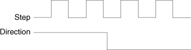

Fast, accurate stepping. The Buildbotics controller achieves smooth step rates up to 250,000 per second, allowing you to use up to 256 microstepping at high speeds. You get fine, precise motion without giving up speed.
Step and direction signals
